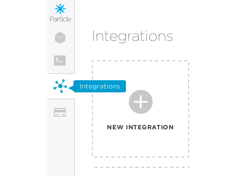

  • Click on Console from the left menu.
  • Click on Integrations button and press in + NEW INTEGRATION.
  • Choose Webhook and press on label Webhook Builder.

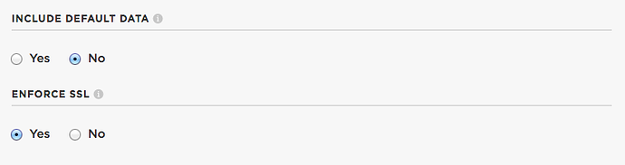

On the option "INCLUDE DEFAULT DATA" press No, to erased the JSON data that Particle sends by default:
