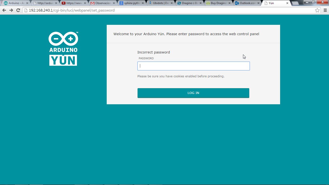

2. Using your computer, scan for the unsecure Arduino-Yun wifi network to begin setting up the “Dragino”.
3. Connect to the free network and open a new web browser. In the browser, enter 192.168.240.1 into URL bar. This command will open the configuration page of the Dragino. The default password for the Dragino device is “arduino”.

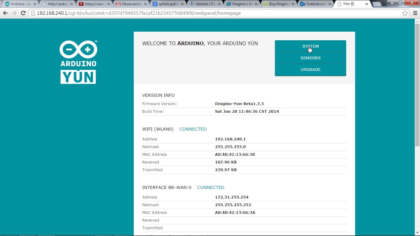

4. Once connected to the device via the web browser, click on “system

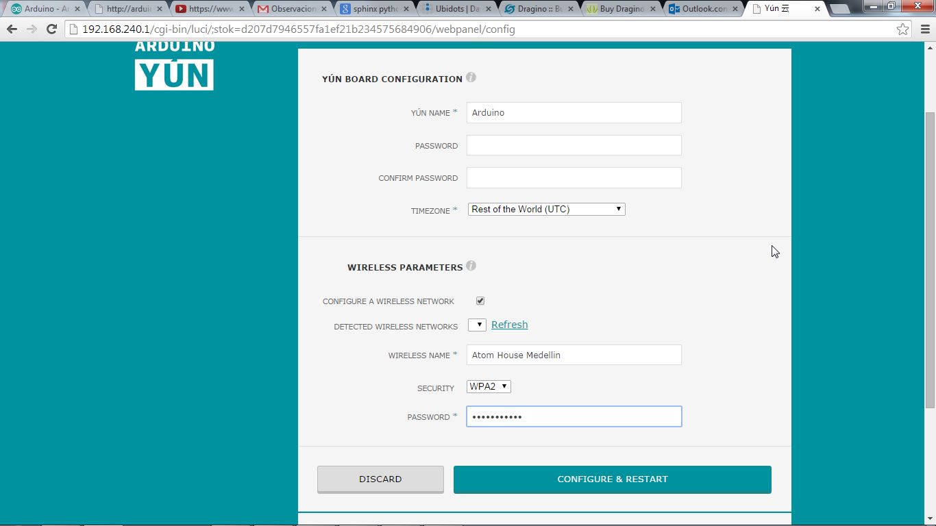

5. Specify the Wireless Parameters of your secure Wi-Fi connection, then press “configure & restart”. This may take several minutes to complete, please be patient.
