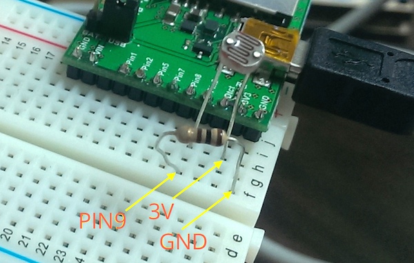

Electric Imp is an IoT Security Platform whose partnership with Ubidots cannot be overlooked. The Imp series offers perhaps the simplest way to enable any physical object to be connected to the Internet thanks to their “Imp001” module (pictured above), a powerful piece of hardware that connects effortlessly to an available WiFi network with a card from-factor 802.11 node. Additionally, this little time-saver will unlock your board to sense its surroundings and send data to the impCentral platform where it can be collected and then be relayed to Ubidots to be made intelligent in your Business Applications.
The imp001 module need to be connected to the April Development Board to be able to program it.

By following  the code provided below you will be able to post the analog readings taken from the Pins #5, #8 and #9

NOTE: The values taken from the analog pins of the imp module are not connected to any sensor, for this reason the values shown above are not related to a real-life example .
