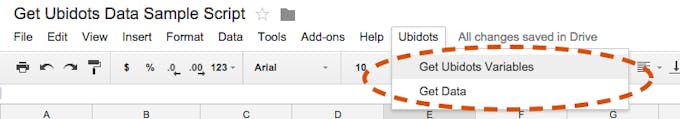

Done! now open your Google Sheet again and you'll see a new menu to trigger the functions:
Finally, run the functions to extract your data. The first "Get Ubidots Variables" will retrieve the variables of the specified data source. The second "Get Data" will retrieve the values of the specified variable. From then on you can create pivot tables, get data from other sources, etc. I.e. How about using Piktochart's Google Sheets integration to create a beautiful report for your customers?
