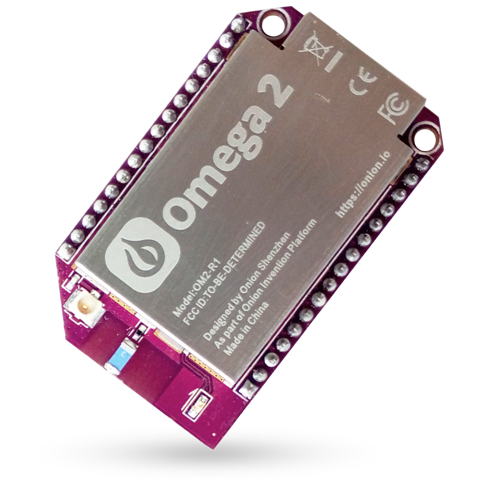

The Omega is an ultra small Wi-Fi development board. Based on Linux, this board was designed specifically for wireless IoT applications. Despite its tiny size, the Omega comes with everything you need to connect your project to the Internet. Then once sending your data to Ubidots you can develop and deploy your custom IoT Application to end-users with ease.
By working through and completing this guide you will be able to send data taken from the pins of the Omega2 board to Ubidots in just a couple of minutes!
