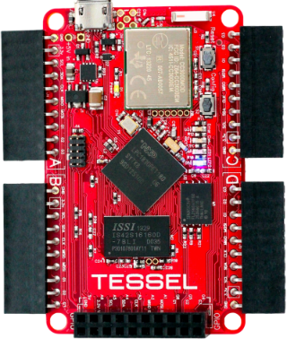

Tessel is a Node-compatible microcontroller with WiFi built in. Tessel offers many modules with sensors attached to it, so you can log physical variables in the web. This tutorial provides the basic functions to push data from one variable to Ubidots, but it could be extended to support more modules and sensors. This tutorial teaches you how to read a noise variable from Tessel’s Ambient Module and send its value to Ubidots.
