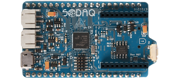

The Autonomo is a compact Arduino-compatible board that uses the Atmel Cortex M0+ 32bit microcontroller. It was designed to be autonomous (self-sufficient) by enabling it to be powered by a solar panel.
