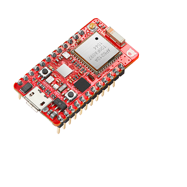

The Duo is a tiny Wi-Fi and BLE hardware development kit that comes with Particle’s firmware by default. The allows us to use Particle’s development environment and enjoy its ease of use, community examples and libraries.

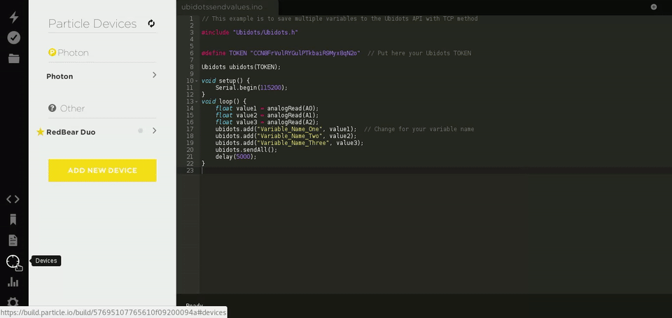

Claim your RedBear Duo in Particle Cloud
  1. Go to Particle.
  2. Click on Devices -> ADD NEW DEVICE.
  3. Paste the ID that you copy in the previous step (Setup). Then click on CLAIM A DEVICE.
Now your RedBear Duo is added to the Particle Cloud.
Include Ubidots library
  1. Click on Libraries -> Community Libraries and type “Ubidots”.
  2. Click on Ubidots library.
  3. Click on INCLUDE IN APP.
  4. Select the APP and then click ADD TO THIS APP.
Now you’re ready to connect to the Ubidots cloud.

Send values to Ubidots
To send values to Ubidots, go to Included Libraries and clic on UBIDOTS and select UbidotsSendValues.cpp, copy it and paste to MYAPP.ino
The function “setDataSourceLabel” only supports alphanumeric characters and these: “.” “:” “-” “_”. If this function is not used, the library will set Particle’s Core ID as the default name.
// This example is to get the last value of variable from the Ubidots API
// This example is to save multiple variables to the Ubidots API with TCP method
 * Include Libraries
#include "Ubidots.h"
 * Define Constants
#define TOKEN "Your_Token"  // Put here your Ubidots TOKEN
Ubidots ubidots(TOKEN);
 * Auxiliar Functions
//Put here your auxiliar functions
 * Main Functions
void setup() {
    Serial.begin(115200);
void loop() {
    float value1 = analogRead(A0);
    float value2 = analogRead(A1);
    float value3 = analogRead(A2);
    ubidots.add("Variable_Name_One", value1);  // Change for your variable name
    ubidots.add("Variable_Name_Two", value2);
    ubidots.add("Variable_Name_Three", value3);
    ubidots.sendAll();
    delay(5000);
