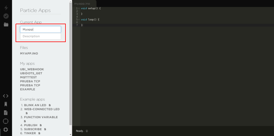

In the Particle’s Web IDE create a new app and set the name.
NOTE: We titled our app "Myapp" whichever name you select, you will need to refer to this same naming later on, when you see "Myapp," know this is just a reference to your Particle IDE application.

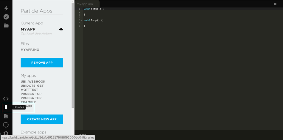

Go to the library tab.

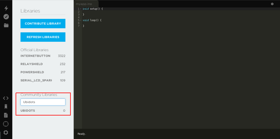

In contributed library write Ubidots and select the Ubidots library. Make sure to add the last version library. Note that there is also an MQTT version. For this tutorial, we will be using the HTTP "Ubidots" library. If you prefer to utilize MQTT protocols please reference this link.
Click on INCLUDE IN APP. And return to “MYAPP.ino” (or whatever you have titled your application) Once included, we can begin with our coding in Particle IDE.
